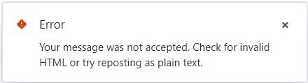

I tried to add here the whole related part from log file, but there is an error popping up, so I cannot send it ??? Too long text (38962 characters) ?
Regards, Stanislav
