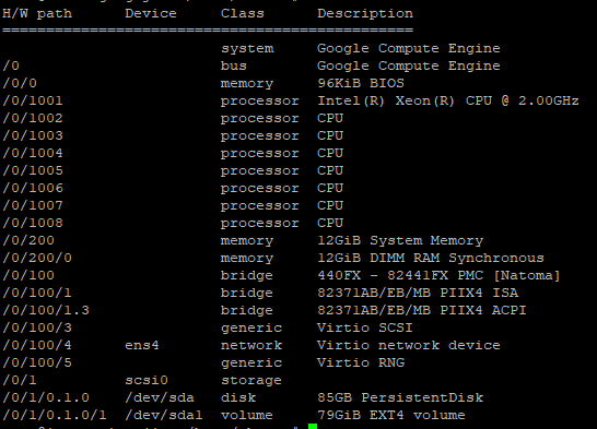

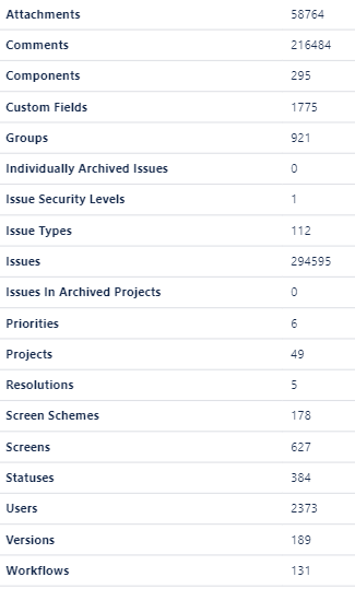

Our Jira Instance(8.1.3) took ~6 Days for a lock and reindex. However, lock and reindex in safe mode is taking just 30mins below are the screenshots for the database statistics and hardware info. Can someone help me in troubleshooting this issue?
I would recommend looking into tuning you Jira memory. https://confluence.atlassian.com/adminjiraserver073/increasing-jira-application-memory-861253796.html
You should also look at how many threads Jira has available to use on the DB and tune it as well. https://confluence.atlassian.com/adminjiraserver/tuning-database-connections-938846864.html

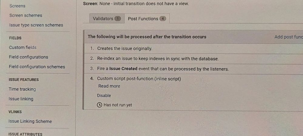

@Nic Brough -Adaptavist- could you please confirm whether the placing of post function custom scripts affect the indexing, I mean in the post function, by default there is a function called Re-index an issue to keep indexes in sync with the database will there be any change in reindex time if custom scripted post function is placed below/above this default function (screenshot attached for reference)
No, as I said already, workflow functions will not affect indexing. They only get run when you are using a transition.
