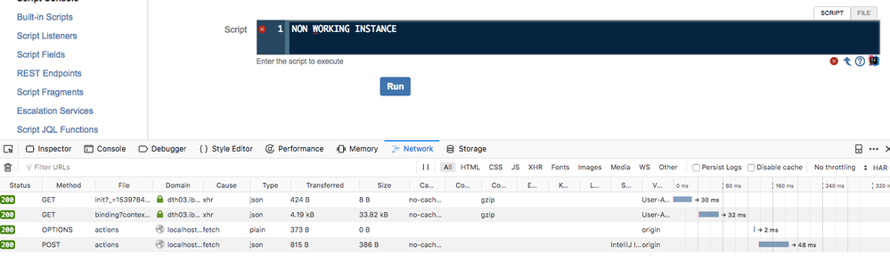

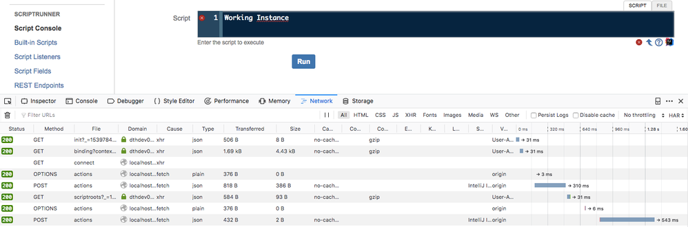

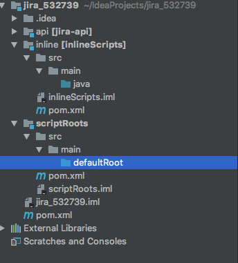

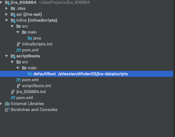

The defaultRoot directory in IntelliJ is missing the path /atlassian/[instancename]/jira-data/scripts (see screenshot)
The browser network-console reveals that some Calls is missing in comparison to the working instance when setting up the integration via the IntelliJ-Button. (see screenshot)
