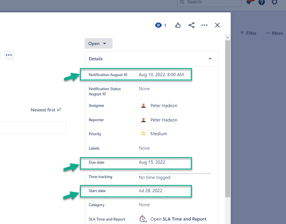

Welcome to the Community! I can recommend you to try an SLA plugin for doing this. For example, SLA Time and Report for Jira add-on.

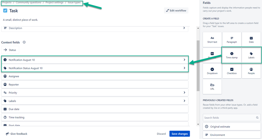

Here you need to create a custom fields "Time stamp" and "Label". After that, select necessary date for the custom field in Jira issue:

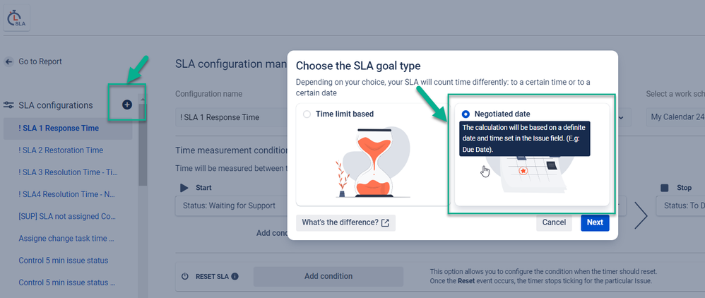

Then go the the SLA Manager, add a new SLA Configuration (choosing the Negotiated date SLA goal type), select the project, add start and stop conditions (for example, To Do as a Start and Done as a Stop conditions):
And after that, set up a time goal. A time goal means when the action should be done. In our case, we can have 1 or a few time goals:

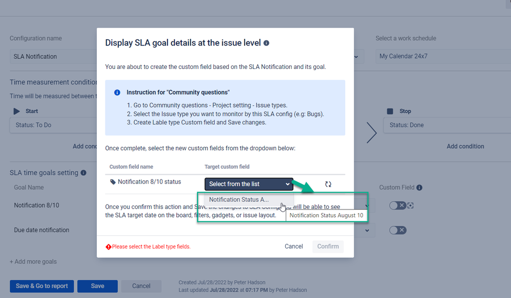

Notif 8.10.png1) Notification on August 10. To receive such a notification, choose a field we created in the "Negotiated date field" and select a person who will get this notification.
And to have this green check mark on the right, just click it and choose the label we've created before.
2) Also, you can receive a notification on the due date. Just add one more time goal and choose a "Due date" field, and choose the time when it should be sent.
