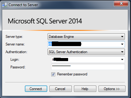

This is our MSSQL 2014 server, This server for production databases of JIRA (JIRA_Prod), Confluence (Conf_Prod), Bamboo (Bam_Prod) and etc.
Now, we are building new linux server (RHEL 7) for JIRA.
My Question: without install MSSQL 2014 in new linux server. Can I connect MSSQL server with New DB JIRA (JIRA_Dev) while installing new JIRA in New Server.
By using above Server Name, login and Password. (with new login and password).
if yes, can copy any DB driver in new linux server.
if no, what is the process?
Daniel Eads
October 14, 2019
Hi @cmbollareddy - you can use a new database on your existing SQL server with your new Jira install.
The Jira installation already contains the database driver needed to connect to MS SQL 2014 - you do not need to copy this over from an existing server.
As far as configuring the database with Jira - in your new install, the first time you start Jira it will ask you for these details in the web interface. The relevant instructions from our SQL 2014 document:
The Jira setup wizard will display when you access Jira for the first time in your browser.
  1. In the first screen, 'Configure Language and Database', set Database Connection to My own database.
  2. Set Database Type to SQL Server.
  3. Fill out the fields, as described in Database connection fields.
  4. Test your connection and save.
