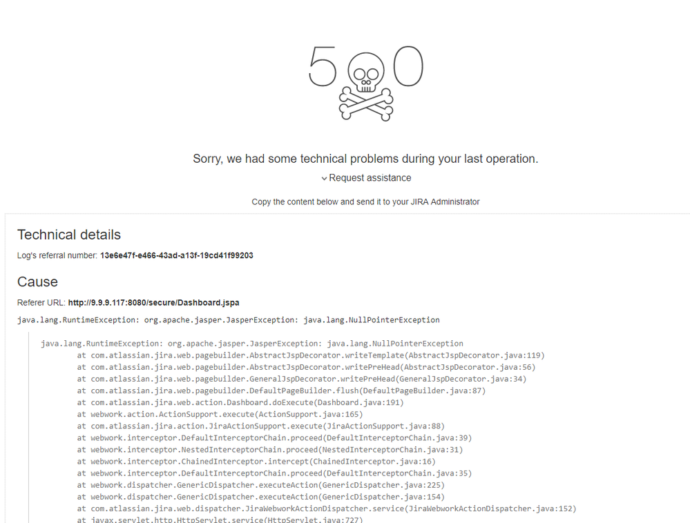

After some investigation I've found out that problem is connected with displaying projects and issues from my previous DB. I've tried to access restored version using user which doesn't have administrative access and everything is working fine.
Also after investigation of the backup file, I've found that JIRA was installed as 6.2.1 and then upgrated to 6.4.1, maybe it is some how connected?
Another question if it is possible to find which resources aren't avaliable?
Right now I'm getting:
Also maybe it is possible to downgrade backup file to previous version? maybe it would be possible to restore file on 6.2.1?
I would try to restore this to a 6.2.1 version first instead. If you can get this restored there and working, then from there you should be able to update the license key for Jira. Doing it this way will then allow you to create a new XML backup, one with an updated license key.
This way you can more likely avoid this kind of error when upgrading later on. Provided the XML backup has a license key that still has a future expiration date, then you should be able to update that version.
yeah, after installing 6.2.1 and importing whole MySQL DB backup everything is running fine. Thx!!
