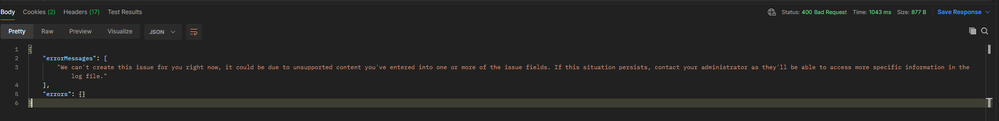

This is the error I get as an HTTP response:
The error from the log is:

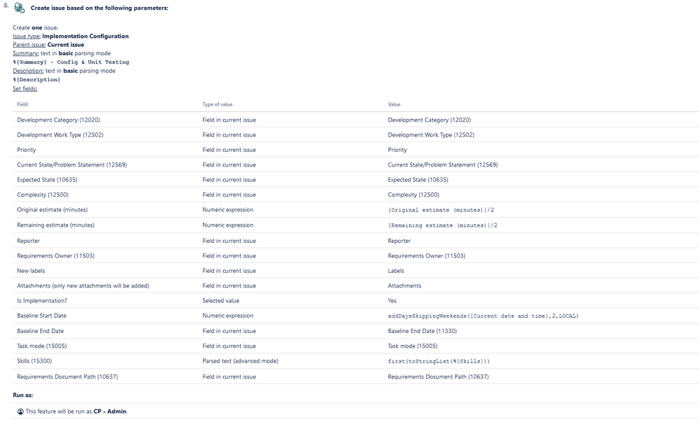

And below is the on create post function:
My testing was to take out all fields in the above post function, run my script and see if the subtask gets created under the main issue or not, if it did, I'd add a new field and test again.
The subtask stopped getting created once I added the "New Labels" field.
I also tried having all the fields in the screenshot above present EXCEPT for the "New Labels" field, and again the subtask was created fine.

And I get more or less the same error message:
That goes away though and creates the issue if I don't include "labels": [""] in my API call.
