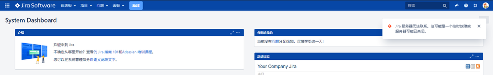

When I install JIRA 8.7.0, everything is normal; but when I install conference 7.3.2 and import JIRA users, ordinary users will log in to JIRA and exit immediately, and this prompt message will appear.
“ JIRA server could not be contacted, this may be a temporary failure or the server may be down.”
But there is no problem when using the administrator account to log in.

I've had to translate your issue into English, but from what I am understanding, Jira 8.7.0 was working fine. You then installed Confluence 7.3.2, and now you're seeing an error whenever you login to Jira.
Can you please let me know what that error message says in English? I'm not able to translate the image.

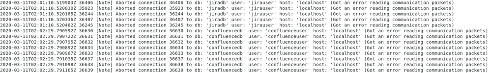

I see this error message in the database log file, but I'm not sure what the impact will be.

That doesn't really tell us what the error is, but it could be something like this:

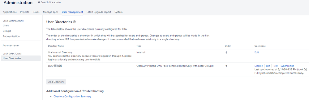

yong hu
March 11, 2020
Hi @Shannon S

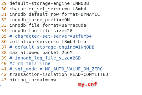

I've set up "max_allowed_packet", which is the configuration added in my "my.cnf".

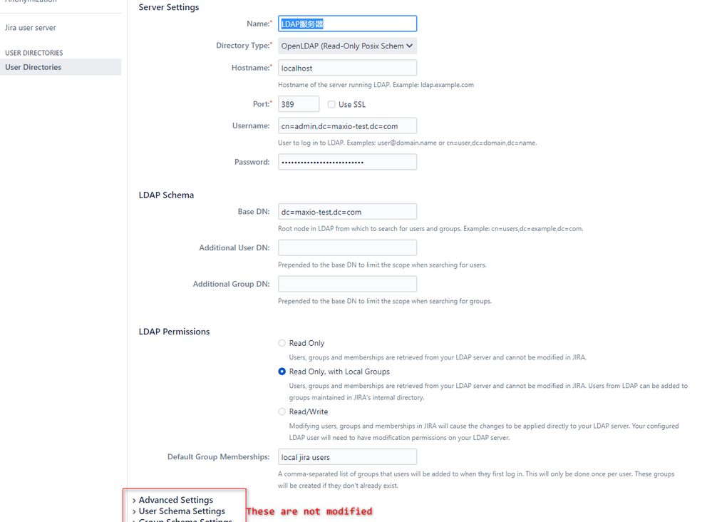

This is my configuration for importing LDAP users in JIRA.

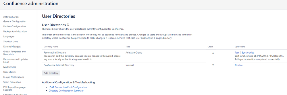

This is the configuration of the JIRA user that I imported in the conference.

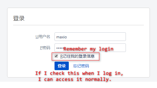

When I log in to JIRA or conference, I need to check "remember my login information".
