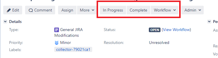

Hi @Nic Brough -Adaptavist- ,
 Thank you for your quick response. The below red color part was missing.
June 8, 2021
Ok, that's the workflow section, not really status, it's listing the transitions out of the current status into others.
There are three reasons it might vanish
  • An admin removed your permission to transition by amending the workflow
  • An admin removed your permission to transition by messing with the permission scheme or group/role membership that the permission scheme uses
  • A fault where the two places the workflow for an issue is stored go out of line - Jira gets confused and offers no transitions in this case.  It's fixed by someone running the integrity checker or changing the current workflow
