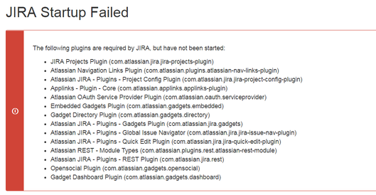

I have a sandbox that I upgraded from 7.0.11 to 7.3.8 and I can't get it to startup due to some plugins being disabled. Before I upgrade my instance I had put the add-ons onto safe mode. After I started JIRA I came across the following error.
I've tried to following the solution on this page with enabling the plugins through mySQL https://confluence.atlassian.com/jirakb/troubleshooting-jira-startup-failed-error-394464512.html#TroubleshootingJIRAStartupFailedError-Time and I don't think this is a time out issue or any of the other issues listed. Also when I look for all the plugins available I can't seem to find the new plugins in the database. I'm wondering I'm missing these plugins from the get go (ie I somehow managed to skip installing them during the upgrade process) or if this is a configuration or some other issue due to me putting the add-ons in safe mode before I upgraded my instance.

Try extending the plugin timeout and try again: https://confluence.atlassian.com/jirakb/jira-applications-system-plugin-timeout-while-waiting-for-add-ons-to-enable-212173447.html
Also, make sure all SYSTEM ADD-ONs and modules are enabled before upgrading JIRA. This shouldn't be a problem for you if you used Safe Mode; however some admins disable things like HipChat module. Make sure all system add-ons are enabled.

I tried extending the timeout to 300 secs and then again to 1200 secs when it didn't work. My JIRA instance starts up just fine now, thank you!
