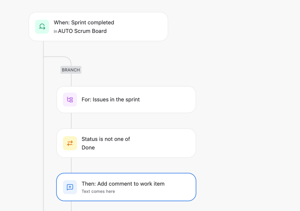

Having said that, when you complete a sprint, this raises a trigger you can leverage in automation to trigger further actions. The below example shows how you can address all issues in the sprint you just completed and add a comment to all open issues (the ones that will spill over):
In the status condition, make sure you exclude all statuses that are not mapped to the rightmost column of your board, as that is how you identify all items that are moving into the next sprint.
I would not recommend to explicitly mention what sprint they are moved into at this point, since it seems quite a relevant scenario to me that this might still change before that sprint is actually started. To refer with a smart value to the sprint that you just completed, you can use {{sprint.name}} to add it to your comment.
