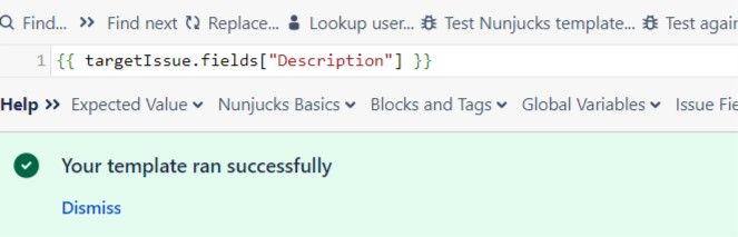

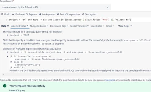

I'm trying to create a post-function by using set issue fields option.
I have to reach fields of linkedissues of current issue.
I have successfully tested jql like below
But I cant reach a field of targetIssues. I have tried this
Although description of target issue is not empty, I cant see the result.

Actually I have solved it :D I had to use dump filter.
{{targetIssue.fields["Total Budget"] | dump }}

I have 2 different types, SAT and Demand,
Demands are linked to one SAT through "relates to" relationship.
In Demand, I have a number field "Budget",
In SAT, I have a number field "Total Budget"
I want to sum "Budget" fields of all linked Demands and write the result to SAT's Total Budget field.
