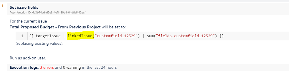

I use the following query to sum the fields in the subtask :
for that query, was successfully executed.
then, I use the following query to sum the fields in the linkissue :
but I get the following error message:
Did I miss something?
David Fischer
April 29, 2024
Hi @RIZKY JTUASIKAL
the name of the filter is linkedIssues (with an "s")

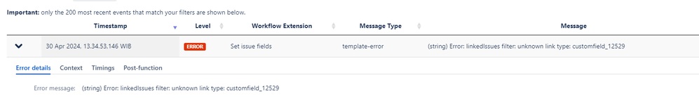

RIZKY JTUASIKAL
April 29, 2024
and one other error message:
David Fischer
April 30, 2024
Hi @RIZKY JTUASIKAL
That's because you need to pass the list of fields as an array:
linkedIssues(["customfield_12529"])
 However, to be fair, I haven't tested this without passing an outside link type name as the first parameter.

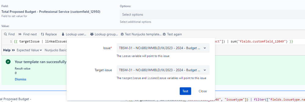

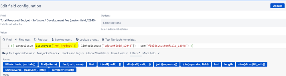

Hi @David Fischer ,
Today (June 05, 2024) I have a problem with this process,
so when I tried to replicate the process, the result is always 0, as you can see on the images below:
But the other day when I tried to run the process,
it works perfectly and there is no error that happened that day.
and heres the query that I'm using:
any suggestion from you, @David Fischer ? :(
Is this a bug? or did I miss something?
