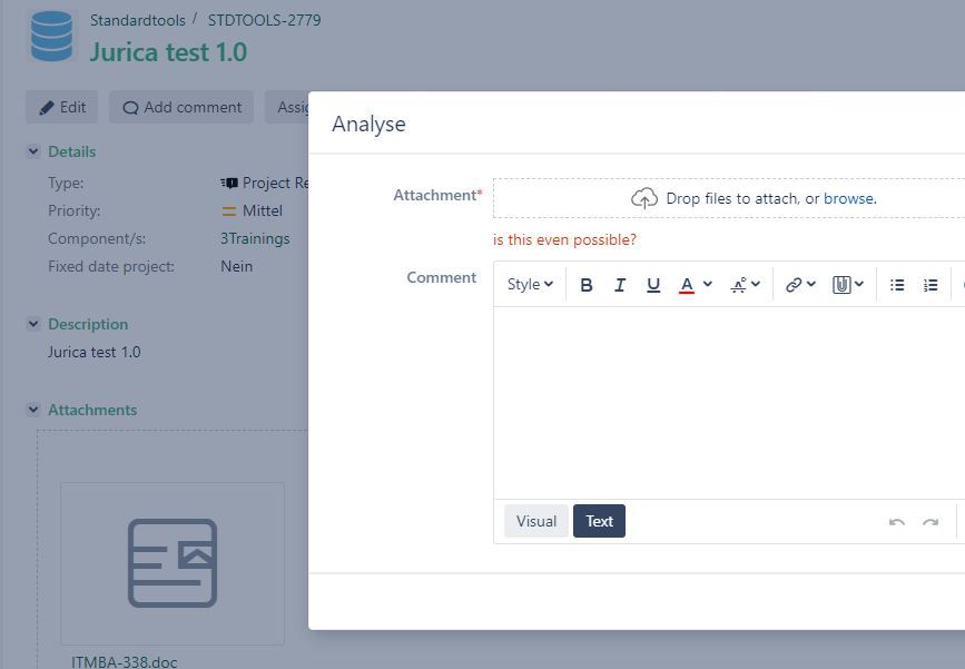

×Hi Community,
is this even possible?
When moving from the "open" status to the "in analysis" status, the attachment field should be mandatory, but if at least one has already been added during the "create" process, then no additional entry in this field is required.
Best regards
Jurica Petricevic

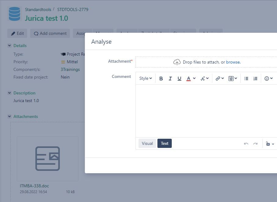

@David Fischer in this case, in a transition screen, I need to force a new attachment to be attached, for QA evidence on the tests performed.
However I tried several ways, however it does not recognize when it attaches to the transition screen, only when it is in the issue view.
I haven't tested it recently, but this should work in a Build-your-own Validator:
!!issue.attachments && issue.attachments.some(it => it.id == null)
@David Fischer WOW
I just applied and it worked the way the rule needed.
I hadn't thought of that solution.
Thank you so much

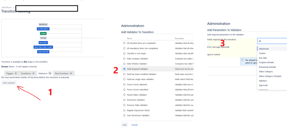

Hello @Jurica Petricevic
you can try to add a new validator to your workflow that requires "Attachment" field not to be empty. To do such a thing, go to the "Workflows", "Edit" and then select that transition from "Open" to "In analysis" status and follow this screen:

Secondly, this does not solve my second part of the problem, where if there is already an attachment, the system ignores this field and releases the transition.
