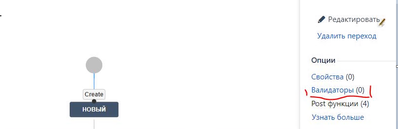

Transition (without validator)

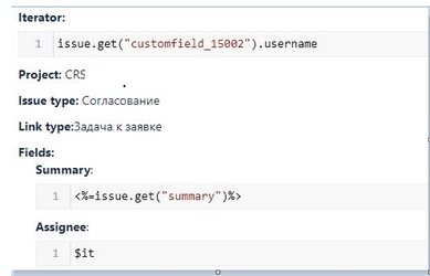

Post-function looks like so

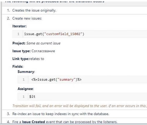

Hi @bedovyi_a_fvolchek_com ,
you just need to update your Iterator script to:
issue.get("customfield_15002")
This will return a list of ApplicationUser objects, which is how Jira represents users internally.

I tried in different way.
When i did iterator without username the result return the same problem
I reproduce the error and sent logs file in request that i did
David Fischer
April 2, 2021
Hi @Aleks ,
I see two problems in the configuration:
1. to avoid errors when the Approvers field is empty, use this iterator script:
issue.get("customfield_15002") ?: []
2. For the Assignee field, either choose the "Set field value to Groovy Expression" option and use this value:
it
or with the "Set field value to Constant or Groovy template" option, use this value:
$it.name

  2. Could you provide us the screenshot of validators,post-functions of this transition and create transition of the target issue?
