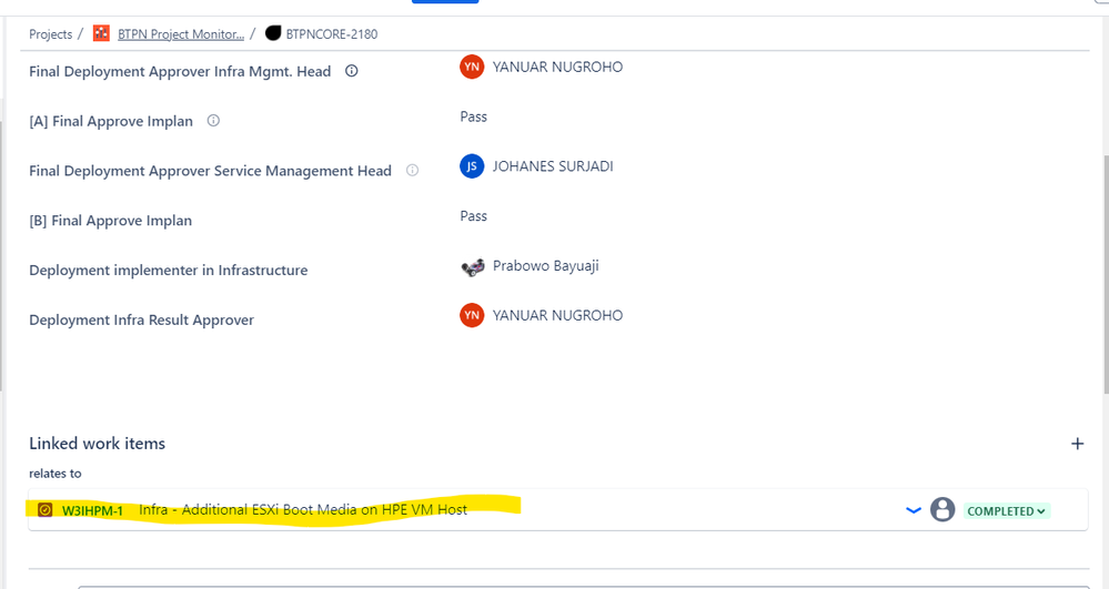

First,
I have issuetype A, B, C, and D
The question is,
How can I get issuetype A, which has no linkissue (relates to) to issuetype B (yellow mark on the picture)?
and if issuetype A has a linkissue to issuetype other than A (issuetype C and D), then it's okay.
Is this possible with jira standard?
Hi Rizky,
Thanks for the clarification. Unfortunately, JQL doesn’t support negative issue link conditions natively. You can't directly reference the issue type of linked issues in a simple JQL statement.
If you have ScriptRunner, you can try using the issueFunction to achieve this or any other marketplace plugin.
