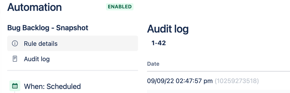

Here's a screenshot from the automation log
I took that date and time and ran the query looking for issues matching at that point in time.
issuetype = bug AND "Product Component[Select List (multiple choices)]" not in (One, Two, Three) AND status was in (Backlog, Blocked, "To Do", Icebox, Open, "In Progress", "In Review") ON "2022/09/09 14:47"

I think I know what happened in my case. Maybe this will explain your discrepancies also.
My user account Preference time zone is set to Los Angeles. The default time zone for my instance is UTC; a 7 hour difference.
In the Audit Log for the Rule, the time stamp display is adjusted for my account Preference timezone.
The time of change for changes to an issue is stored in the database to match the timezone of the instance.
I have determined that the <timestamp> value used in the Advanced Issue Search screen for the ON predicate is being compared to the timestamp of status changes as they are recorded in the database - which for me is UTC (the time zone setting of the instance).
So, when I put "2022-09-09 14:44" (the Los Angeles-relative time stamp from the audit log) into my advanced search, it was assumed by the comparison to be UTC (the timezone of date/times in the issue change log). 7 hours ago that fourth issue of mine was still in the Backlog status. When I modified that timestamp to align with the UTC time at which the status change occurred for the fourth issue, I found that the fourth issue was properly excluded.
Given that information, does that explain the discrepancies in your case also?
