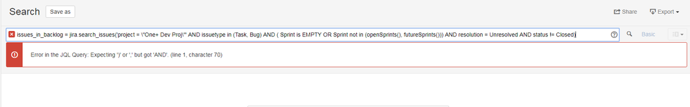

Hi @Leo ,
Earlier, I'd run this query for getting all the issues in the project, and this worked perfectly for me. I'm pasting the query so you could use it for your reference.
issues_in_project = jira.search_issues('project = \"One+ Dev Proj\"', startAt=0, maxResults=1000,validate_query=True,fields=None,expand=None,json_result=None)
So, the only difference that should happen here will be in the JQL, since it'll be refined only for getting the backlogs.
I've attached the Advanced Search box screenshot, where I'm getting the Syntax Error, for the Backlog Query.
Could you please have a look at this query, and point out where I'm going wrong.

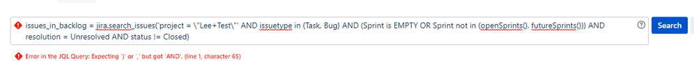

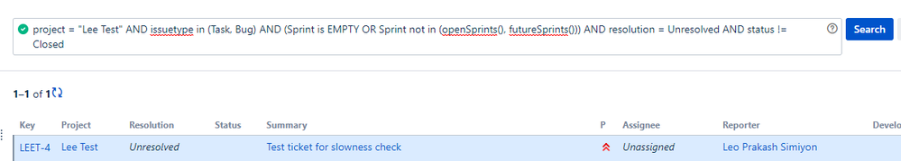

Hi @Pranay Verma,
I don't think the way you put your query in advance search will work, as you are invoking python code there, I'll attach both screen shots from my window where python code will throw error and only the JQL query will succeed.

Hi @Leo ,
Yes I'm aware that the below one won't succeed in this window. I was successfully able to run the JQL in the advanced search box. I just wanted to point out the previous python code and the new one, so that you could compare and point out to a potential syntax error, since as I earlier mentioned the only difference in the jira.search_issues() method would be only in the JQL.
Could you help me with the syntax if possible?
