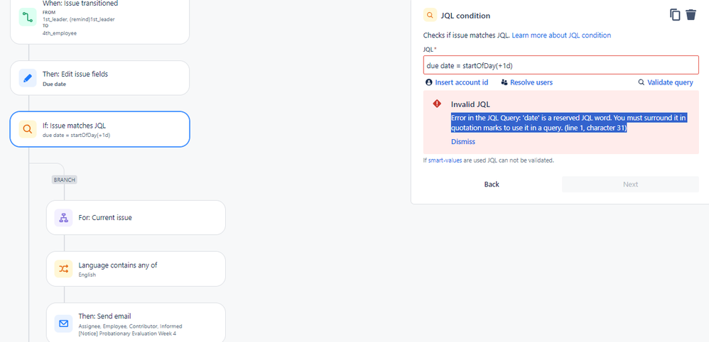

I want to send an email 3 days before the due date, so I set the JQL condition like:
due date = startOfDay(+1d)
The message I received from the Validate query was as follows.
Error in the JQL Query: 'date' is a reserved JQL word. You must surround it in quotation marks to use it in a query. (line 1, character 31)
What did I do wrong?

Hi Min,
For date values in the future you don't need the +. So duedate = startOfDay(3d) would cover it. Alternatively you could use duedate = startOfDay("+3d"). For date values in the past you would use the - symbol. startOfDay("-3d") would be the start of day, three days ago).
Looking at your automation there are a few other points to keep in mind:
  • double check what the due date field is actually called. I believe it is either "due" or "duedate". But it may be different for your instance.
  • It looks like you are editing the due date, then checking that same field as a condition for the rest of the automation. You will probably need a re-fetch issue data action in between. Otherwise the automation will check against the due date before the edit.
  • Do keep in mind that this will only send an email when the due date is 3 days from now at the moment the issue is transitioned. If you want to send an email at a later point in time you will need a separate automation that runs on a schedule.
Hope this helps!

Trudy Claspill
November 29, 2023
Hello @min
You don't need the "+" within the parameters for the startOfDay function. The function will assume you mean "+" unless you explicitly insert "-".
Additionally, if you want the message sent when the due date is 3 days in the future you need to use "3" rather than "1" in the startOfDay parameter.

I use '' to due date.
Then...
BHANU TEJA
November 29, 2023
Hi @min
duedate <= startOfDay(3) can you try this
Trudy Claspill
November 29, 2023
@BHANU TEJA
That will not meet the requirement because it will say the issue matches if it is more than 3 days before the due date. The post is asking to match issues that are exactly 3 days before their due date.
