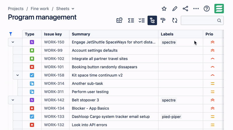

Hannes Obweger - JXL for Jira
February 23, 2023
Just to expand on the last point, this is how this would look in the app that my team is working on, JXL for Jira; TLDR: You'd create a sheet with your relevant issues, enable the default hierarchy (that's just one click), and then use JXL's various filtering capabilities to narrow down your list of issues:
Once you have your list of issues, you can work on these directly in JXL (much like you'd do in e.g. Excel or Google Sheets), trigger various operations in Jira, or export them for further processing.

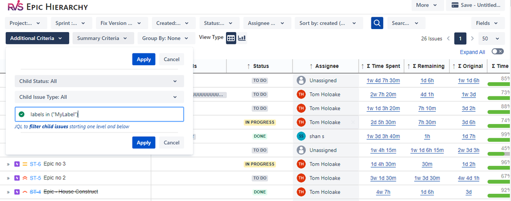

Rahul_RVS
February 26, 2023
Hi @Anita Sudan
As mentioned by other community members an app can help to get this data.
If you are fine with it, you can try out our add-on.
Issue Hierarchy Reports
The app will show you the default Epic Hierarchy and also let your filter on the child issues using JQL.
Disclaimer : I work for the vendor who built this app
