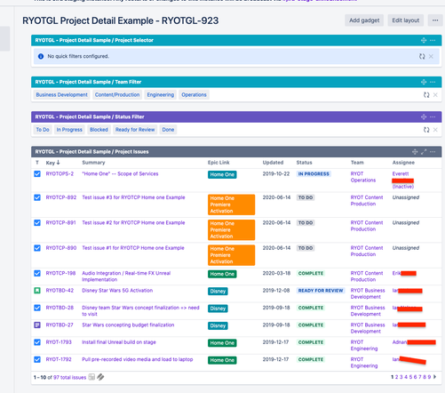

The reason I need this is because a project manager that I work for wants to use a rich filter dashboard to display all issues associated to an Initiative issue of choice and query down to specifics with the use of rich filter gadgets (see below):
In the example above, this rich filter dashboard works off of this query:
issuekey in childIssuesOf(RYOTGL-923)
I don't want to just restrict the dashboard to look at only one initiative (RYOTGL-923), but I want to be able to look into any initiative issue chosen. I need to see if there's a way that I can edit the "Project Selector" controller gadget that would allow the user to select from a list of initiatives from a project, and still maintain the functionality of the "Project Issues" dashboard, which displays the filter results of the query the dashboard works off of.
