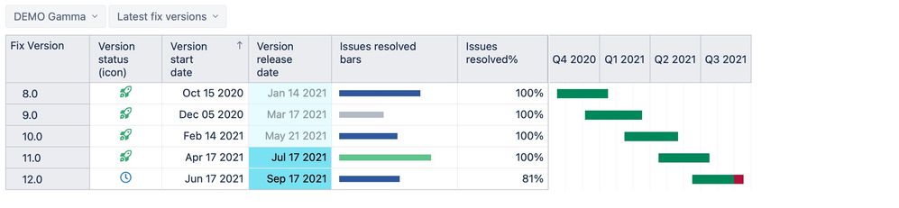

If you are looking at how to make reports about your version release date, you may want to explore the "eazyBI for Jira" app with a native Jira integration.
Here is a demo report for Version releases in the Gantt chart that uses "Version release date": https://eazybi.com/accounts/1000/cubes/Issues/reports/754436-fix-version-release-gantt-chart
