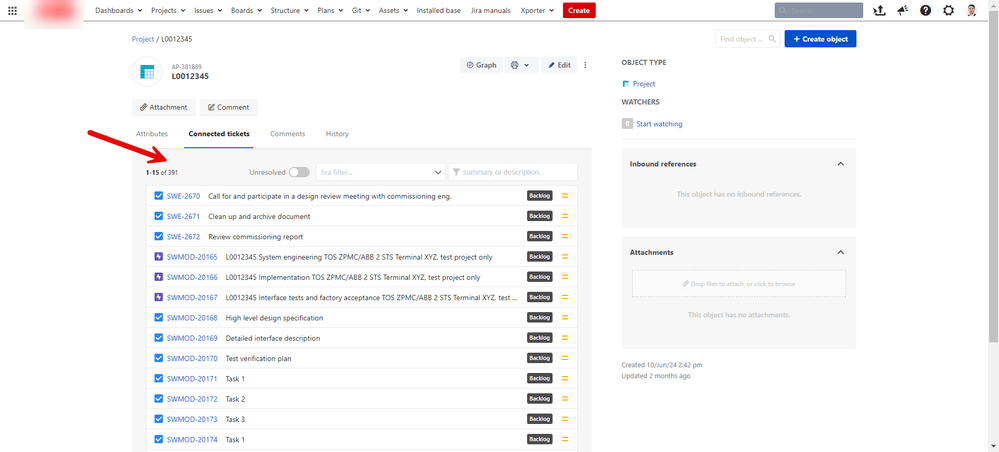

I enclose some pictures showing the object, attribute, and search result.
