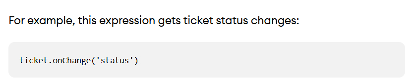

Hey @Jay Whitman - did you find a solution? If you are open to working with a 3rd party this is quick and easy with minware - set the date picker and use this expression (can be further customized depending on the level of detail you need):
We offer a free trial if you want to check it out!
