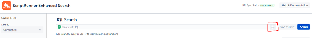

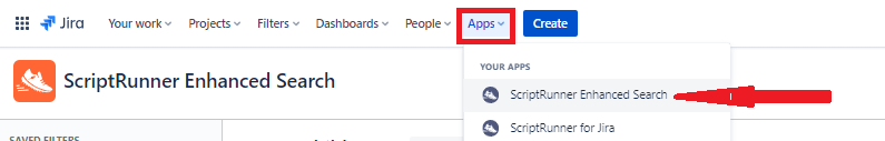

If you are already using the ScriptRunner Plugin in your Jira Cloud instance then you Go to ScriptRunner Enhanced Search
and Click on + icon as highlighted in below screenshot

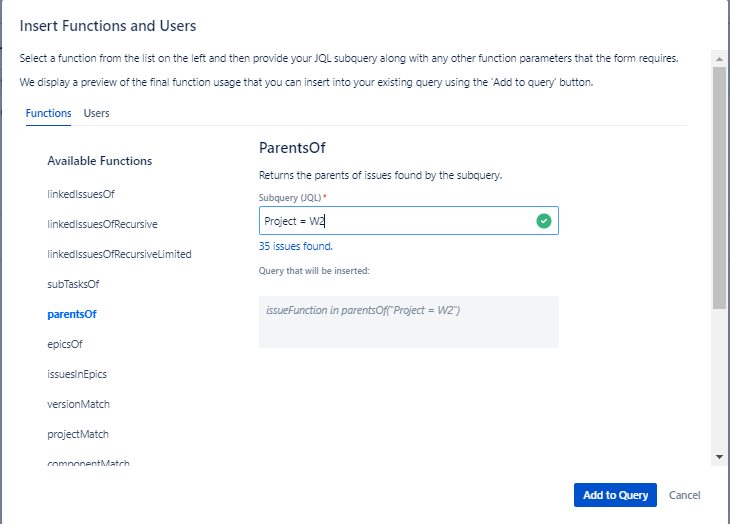

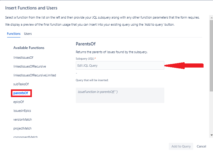

Click on parentsOf on left panel and then type the Subquery as per your requirement and click on Add to Query button
in below example I have added the Subquery as Project = W2
After clicking on the Add to Query button, you will get screen like below:

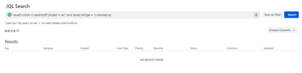

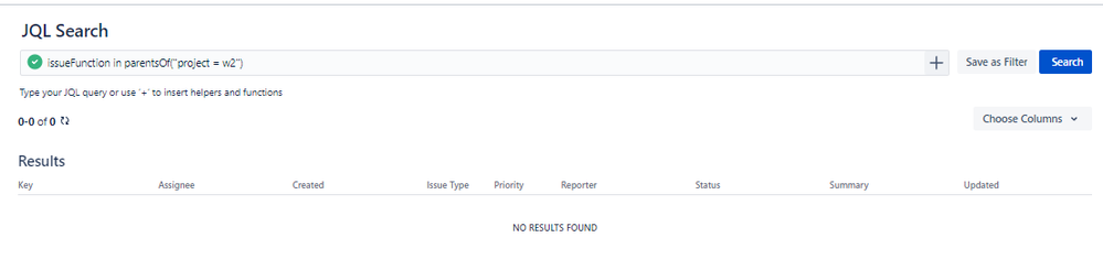

here you need to add on more query i.e., issueLinkType = "is blocked by" that will filter your search result and only extract those issues from the project that has child issues and is blocked by another issue.
Your final query to the above screen will have JQL issueFunction in parentsOf("project = w2") and issueLinkType = "is blocked by" as shown in below screenshot.

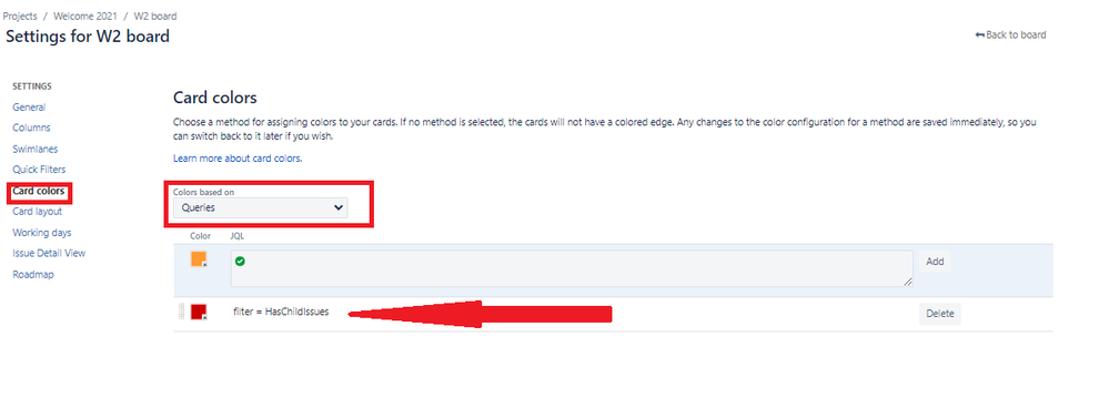

After that click on Search button it will give you the result. And then Click on Save as filter and call the filter to your board Card Color section like below:
That's all you will have the card of an task issue in Red when it has a child issue that also can't be done because its blocked by another task

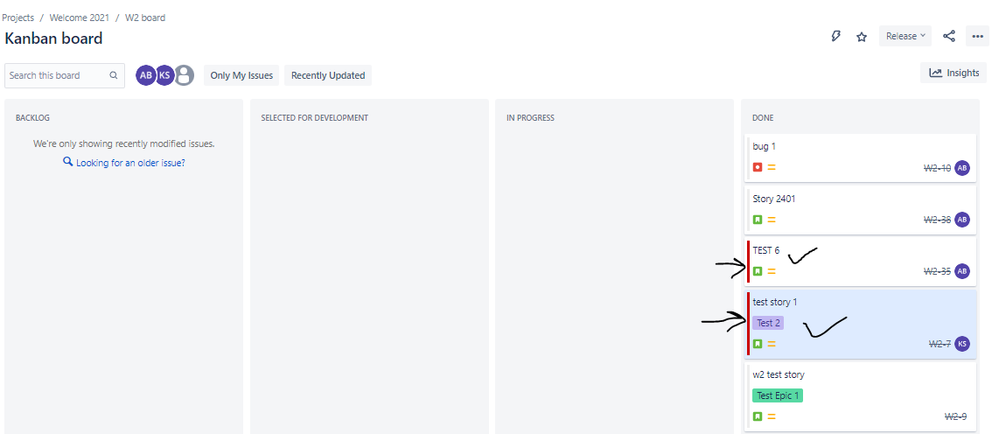

I have one story with all subtasks closed (Showing red)
I have one story with open subtasks (showing green)
Task doesn't show color at all.
What am I doing wrong?
