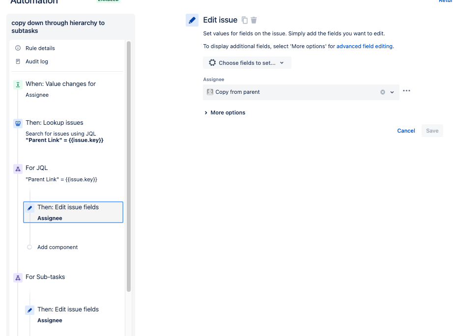

You can do this through Automation rules.
For populating from the higher levels down through the subtasks of child issues of Epics you would use a rule like this:

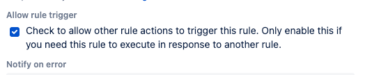

On the Rule Details page you would also need the check this box:
