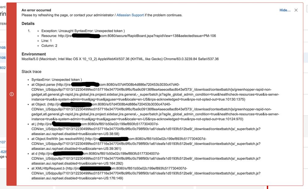

I am having the following issue when accessing any board in Jira:
Exception: Uncaught SyntaxError: Unexpected token )

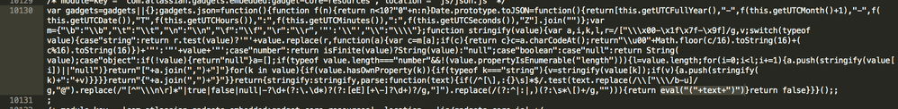

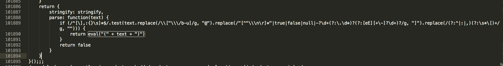

After analyzing the logs and the javascripts I found that the problem is being triggered by an "eval" function inside the stringify function (see images below):
Screen Shot 2018-01-03 at 9.18.07 AM.png Screen Shot 2018-01-03 at 9.17.53 AM.png
I've tried to restart Jira and that didn't solve the problem. I've also tried to use it in safe mode and to disable all the add-ons that could be causing this issue, but the problem persists.
