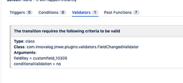

As an EXE on what to look for, Lets say you had a workflow validator from JWME, and the add-on was missing or disabled post migration it will show up like this, noting that it is not basic human readable but rather broken down int class and arguments:

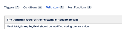

When JMWE is installed and running correctly it shows up like this:
The Class section is what to look at though to get the information on the add-on that is erring, you can then look at your startup logs or application.xml from a backup and search for that class to get more details on the plugin
Another option is to look through the logging and you will see various "ClassNotFoundException" errors when you load an issues that the transition is missing from, and the error stack should spit out the plugin class that is triggering the errors in the same format as my ui exe of JWME above which would look like this: "com.innovalog.jmwe.plugins.validators.FieldChangedValidator" and this will give you a clear indicator of what plugin is triggering the error. Either meaning the add-on is Required to complete the requested action and that it is missing, disabled, incompatible, or encountering a bug of some kind.
