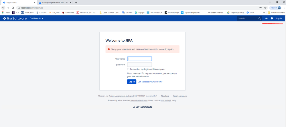

Hayk Petrosyan December 6, 2019
I am sorry to reopen this, but after Jira install on my local PC there is no admin menu there. And I cannot login to Jira((
can someone help please?
Nic Brough -Adaptavist-
December 7, 2019
You will only get the admin menu after you log in as an admin.
Can you confirm that you cannot log in because you have lost your username and/or password?  Have you tried the "forgot password" link?
Hayk Petrosyan December 7, 2019
Thansk for the answer
1) I login as Admin in my PC, still there is no admin menu
2) If by Login as admin, you mean login in Jira. than I do not know how to do that
I tried "forgot password" link, but Jira does not send me any email.
That is separate issue, that it cannot send emails((
So no way to login Jira. Really very surprised with such a buggy behavioral
December 7, 2019
It's not a bug, it's doing a sensible and secure thing.
It sounds like you are mixing up "log in to machine" with "log into Jira".  Just because you're an admin on your PC does not mean you are logging into another system (unless you've set that system up to automatically use your PC as the authorisation)
To log into Jira, you need to use the username and password you set up when you installed it (I can see it's running on localhost, which tells me its a local install that you did)
