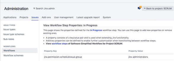

That said, I did try this out myself, and I found I could still restrict this permission via a workflow property in my Jira 7.12.3 version.   I will try to share my steps with you here.  Since I think you are primarily concerned with the ranking aspect here, I used a workflow property specifically to restrict the schedule property.  You could use the edit, but this restricts all kinds of edit to the issues in that state.
For my workflow in question, I edited the workflow, in the 'In Progress' state, I clicked the 'View properties' link for that state, and in that property I added a
Property Key
jira.permission.scheduleissue.group
Property Value
jira-administrators
Note: After you add this, you do need to publish that workflow again in order for this setting to take effect.
Second Note:  Make sure you're adding this property to the status properties and not the transition properties.  For this to work, the property has to be set on the status, not the transition itself.  These can look very similar and get confusing sometimes.

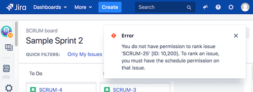

In my setup, for this specific project, only users in the jira-administrators group can actually change the rank/scheduling of any issue in the status of 'In progress'.  Other users of that board/project that are not in that group can't change the schedule.  When they try to do this on the board, they get an error such as
However in my setup, that user does have the edit/schedule permissions in that project, and they can do that for issues in that project, but not the 'In Progress' issues because of the workflow property.
