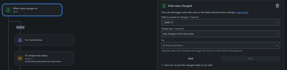

Patricia Caballero Leal March 17, 2025
Thank you for your response Bill,
I have been able to create the automation to add a label when an issue is added after the sprint started only for the active sprint so that is not added in previous stages. This automation is also removing the label when the issue is taken back from the active sprint to previous stages.
trigger3.pngtrigger2.pngtrigger 1.pngCaptura de pantalla 2025-03-17 110739.pngCaptura de pantalla 2025-03-17 110723.png

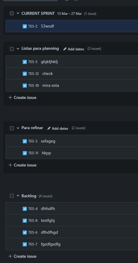

The only problem I have now is that this label is not added when the issue when trough different active sprints like this:
¿Any idea on how can I solve this last issue?
Thanks in advance.
Bill Sheboy
March 17, 2025
Thank you for those images.  I see two problems with the rule you show:
First, within an issue the sprint field is a list of values.  And the condition inside of the branch is checking {{issue.sprint.state}} That could produce a list of values, such as:
closed, closed
or
closed, closed, active
Perhaps try testing this way with the smart values condition to detect when the issue is not in the active sprint:
  • smart values condition
    • first value: {{#issue.sprint}}{{#if(equals(state, "active"))}}{{name}}{{/}}{{/}}
    • condition: equals
    • second value: leave as empty
This could also be tested more easily with a JQL condition on the issue:
(sprint NOT IN openSprints() OR sprint IS EMPTY)
Next, when a rule edits an issue in the cloud, it does not automatically refresh the data the rule holds.  And thus your update of the Labels in the branch is not visible to the rest of the rule, and so could fail the later condition.
When you want the updates to be visible, add the Re-fetch Issue action after the first edit action.
