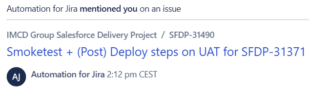

As my question states - I have a few follow-up tasks created automatically whenever a story reaches a specific status in the Workflow.
If we tag a User in Story, it will automatically tag them in the follow-up story.
It is quite annoying whenever the Product Owner or Business Process Owner is flooded with dozens of notifications on issues that are irrelevant to them at this stage.
Is there any way we can switch it off?

What I can tell is that users are receiving Email notifications from the Automation User (as the Automation User is used for that).
It is exactly as mentioned, the User is mentioned in the Parent in the description field, cloning that field to a new story, and keeps sending those email notifications (also ring bells in JIRA itself).
