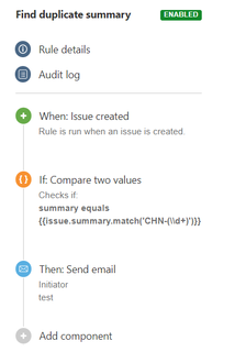

@Bill Sheboy my usecase is quite similar to the one of @Yohan Brunet
The only difference is that I would search for a variable String which starts with a predefined String in this case "TEST-" followed by a integer value which is flexible. What I want to find out if there a similar issues existing, containing this String anywhere in the summary.
The background is that we use it to control our test cases and I would like to find out if there are duplicates because the cases are created by an adjacent system.
I tried it with the following query but the match method doesn't seem to be the right one for this usecase.

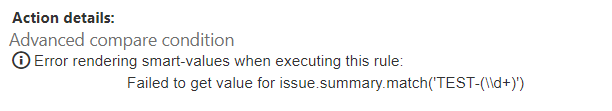

Currently I am receiving the following error:
Maybe you got an idea how to solve this.

Hi @Tobias
Three things to try/consider...
a) Are you just trying to get the numeric value after that string?  If so, please try this expression:
{{issue.summary.match("TEST-(\d+)")}}
b) Might there be multiple results in your summary?  If so, consider how you want to proceed, as that regEx will only return the first one found.  If you want them all, you need to use a split() first, allowing the match() to iterate over the split substrings.
c) The documentation for the match() function says the "underlying implementation is based on Java's Pattern class", and so I recommend using the simplest expression which can solve your need, and to then test thoroughly.
