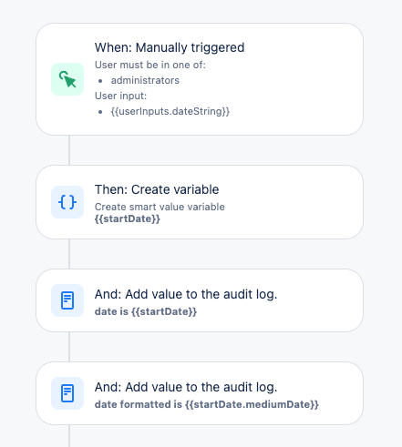

I am trying to create a date smart value to be used for start date and due date for subsequent issues created in the same automation.
The create smart variable step is

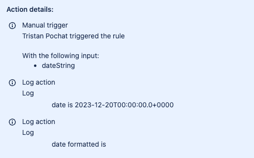

I run this rule with manual input `2023-12-20`
And I get this log
Why can I not format my date even though it looks like it is correctly cast as a date when I create it ?

@TP that happens because when you create a variable, it will always return a string.
Create variable
  • Use smart values here: Yes
Define your own smart value, which can be used in other actions and conditions in the same rule. The smart value you define can consist of other smart values, as well as math functions.
Note that this will always return a string. For example, if you created variable called Stakeholders with the smart value {{issue.watchers.distinct}}, your variable would return the list of watchers but the list would be rendered as a string.
So in your last log action, you will need to convert the variable back to a date first and then you can format it in whichever way you want:
  • {{startDate.toDate.mediumDate}}
