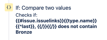

Another brute-force way to try this is to join the links names into a string...
{{#issue.issuelinks}}{{type.name}}{{^last}}, {{/}}{{/}}and then check for the word "Bronze" being absent to clear the setting. Seems overkill when the links should work with those dedicated automation tests and actions.
After a few errors of troubleshooting and trial and error, I ended up using your brute force method which worked. I'm really at a loss as to why I couldn't get the built-in functionality to work. I'll chalk it up to my lack of experience in Jira. Thank you @Bill Sheboy for the assistance.
For anyone that comes across this question in the future, I added the following rule in place of the "Linked Issues not present" step in my original image:
