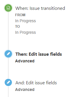

I am trying to use the Jira automation to edit a multi user picker field. What I am trying to achieve is, when people "approve" the ticket using the transition, I have an automation which add the user to my multi user picker cf "approved by" and it remove him from "approvers".
I am using the following but can't make it work properly :
and I have the following code :

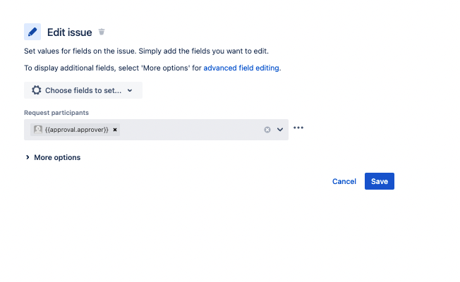

Maybe the smart value {{approval.approver}} is your solution.
Regards
Arthur S
March 2, 2022
Hi @d_kirsching thank you, I found the right solution, I tried your proposal and it did not add the user to the list. But based on what you proposer, I tried with {{initiator.accountId}} instead in the "Request participants" field, and it adds me my user.

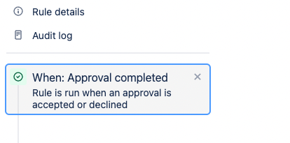

For me it'w working with the trigger Approval completed
Arthur S
March 2, 2022
I'm on Jira software and not Jira service management, so I don't have the "Approval completed". For me it should work on the Edit Issue but I don't know why, it's not.
