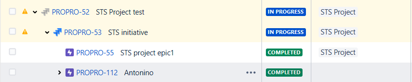

My purpose is to create a rule that set an initiative to completed status as all its child epics are set to completed status, in particular when the last child issue (epic) status transit to completed.
Here is a hierarchy:project Initiative-epics.png

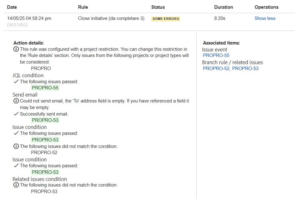

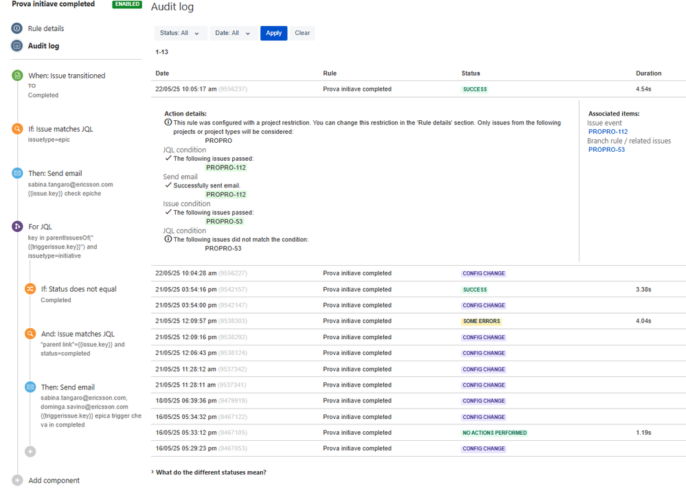

I changed the epic "PROPRO-55" status from progress to completed, but the initiative "PROPRO-53" did not change its status from progress to completed.
Could you please help me on it?

First the "some errors" status of the rule is referring to the problem with the Send email action having no value for the To field.
Second, by using the parentIssuesOf() function you are getting both the direct parent and the grandparent of the Epic. I think you don't want the grandparent, do you? So you might want to add a Condition within that branch to check that the issue you are working on in the branch is an Initiative. Since the rule is trying to process both the parent and grandparent through the branch I'm having a little trouble deciphering the audit log entries.
Can you update the branch with the Condition I suggested and try the actions to run the rule again, and share the output?

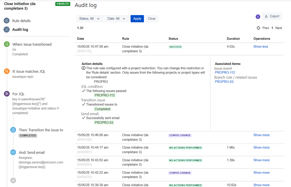

Sabina Tangaro May 15, 2025
Hi Trudy, I've changed the branch as you suggested, but there is a missing condition, all epics must be in completed status. So my question is: is there a way to bind the initiative status transition when all its child epics are completed?
Following the new automation and related audit log:
BR Sabina

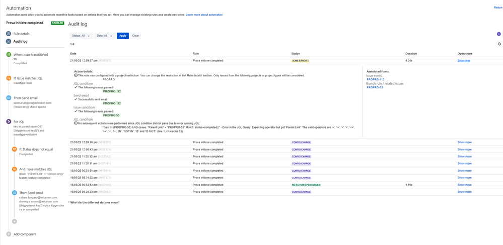

Dominga Savino May 21, 2025

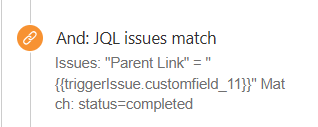

Hi Trudy, we have tried this automation but we have the reported error.Automation 1.png
Trudy Claspill
May 21, 2025
Please post the details of your JQL issues match step. The error is indicating that you have entered an improper JQL statement there.
I think what you have entered has at the beginning
issues:
That would not be valid JQL. You need to remove that from the JQL statement.

Are you suggesting to change the JQL in this one?
"parent link"={{issue.key}} and status=completed
Also in this way it doen't work.

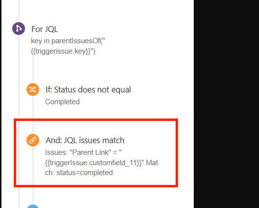

Based on the last image you posted, this was the condition I was talking about.
Before this last change you made, it looked like this
With your update you changed {triggerIssue.customfield_11}} to {{issue.key}}. Revert that specific portion to what you had before the change.

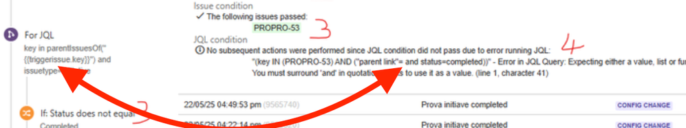

dominga_savino May 22, 2025

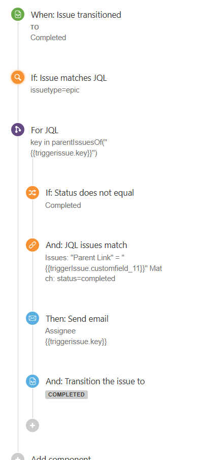

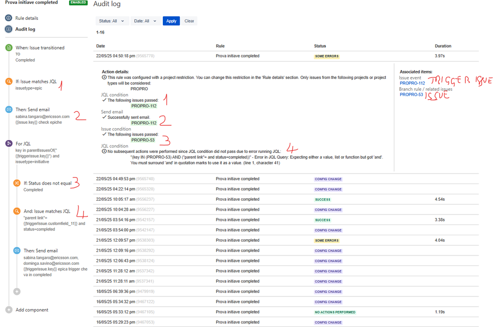

I made this change, but something doesn't work (see message error 4 in picture "Automation 3" attached). It seems like the smart value {{triggerIssue.customfield_11}} does not return the expected result.
Anyway I don't understant the logic. If I look at the message error 4, it seems that if I use a condition inside the violet branch "For JWL" all the following conditions are linked with an AND operator (see error 4 related to the last condition).
In this scenario I don't see how I can extract the list of Epics child of a given Initiative if the JQL I use includes the condition Key= Parent Initiative Key.

The rule is not getting any sort of value from {{triggerIssue.customfield_11}}, so there is no value being substituted into the JQL. You can see this in the error message. Notice that there is no value where the value from {{triggerIssue.customfield_11}} should be. So the JQL statement is invalid.
Where did you get the information that the Parent of the child issue is stored in the field referenced by "customfield_11"?
I assumed that you were intentionally obscuring the real custom field ID with that data.
If you don't have the correct field specified there, then the JQL will not work.
One way to find the correct field name is:
1. Make note of an Epic issue key where that Epic is the child of an Initiative.
2. Open a browser tab and plugin the following URL. Substitute the base URL for your instance and the issue key for the Epic.
https://baseURL/rest/api/2/issue/issueKey
That will output all the fields and their values for the specified Epic. Search through that output for the issue key of the Epic's parent Initiative. That will appear with the field name it is stored in near it.
