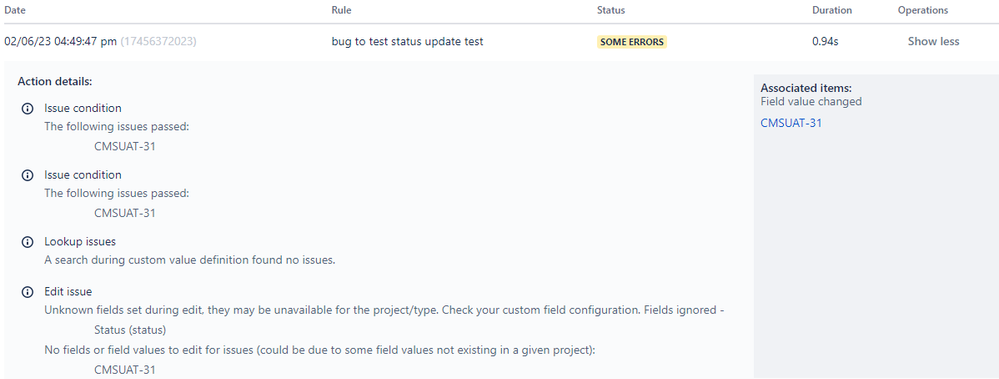

This is the audit log, where CMSUAT-31 is the bug created from the test execution not found:

This is CMSUAT-31, bug created from CMSUAT-26 test, but as you can see, there's no apparent link on the bug screen as we would expect based on the zephyr settings (in our configuration, the linked issues would typically appear between environment and activity):
These are the components of the rule I think you're asking for - let me know if that's not what you needed.

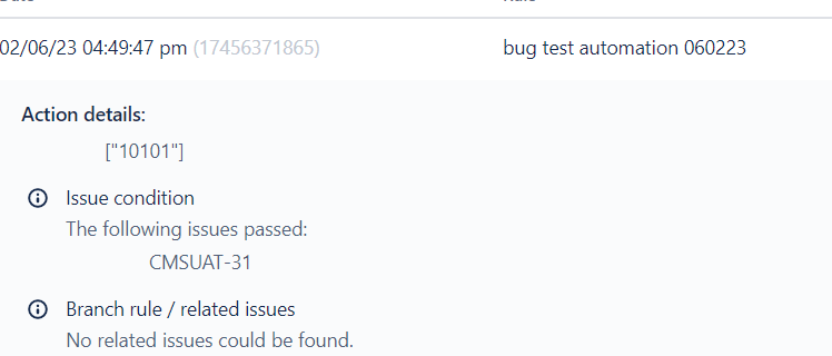

We did try another variation using the branch feature, but it's not giving us the results we're looking for either:
This one appears to not be finding any linked issues either:
