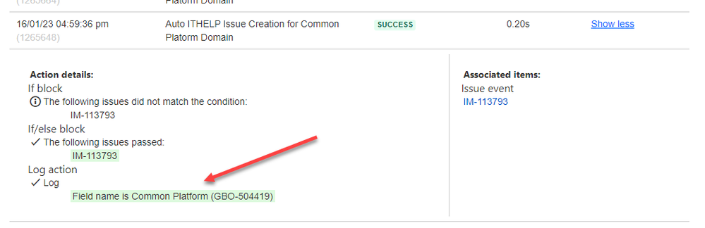

From the audit log, I used
Field name is {{issue.fields.customfield_25900}}
It returns the following - Field name is Common Platform (GBO-504419)
The field value is "Common Platform" (See image below)
However, if I try to incorporate this field in my condition testing (i.e. equals/contains etc) against the value above, the condition fails and thus no logging action executed.

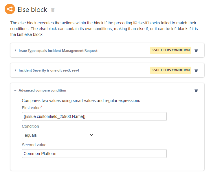

Example -

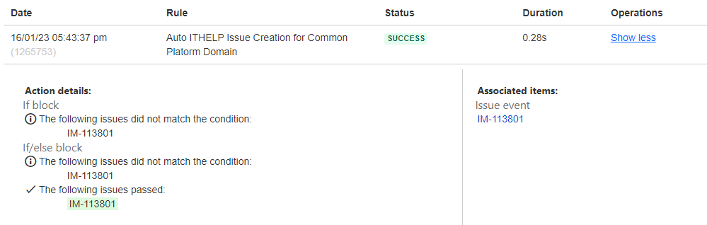

This is what I am getting in the rule audit log entry -
For some reason, I am missing something. This automation rule setup is against our Jira/JSM Data Center envs.
Any advise or hint?

I would try doing some tests with Audit logs, seeing what is output when you do:
{{issue.customfield_25900.Name}}
And also:
{{issue.customfield_25900}}
