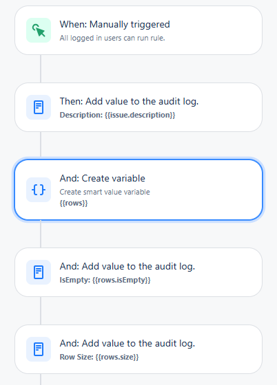

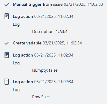

I am trying to write a very simple automation to parse the description field from a story that contains the text 1:2:3:4 and use the Log action to output its empty status, size, and each list item. What I am seeing is that when I run it, I can output the string in the description, it tells me the smart value is not empty and I can't output the first list item from the split command when I try {{row.get(0)}}. Any idea what I am missing? Every example that I have tried has the same result.

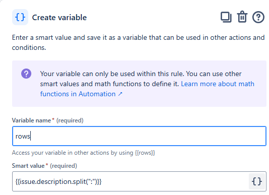

Created variables are always text type. And when you split() the Description field, the result is the rows variable gets this:
When you later want to return to a list, the split() command is needed again. For example, to get the size:
{{rows.split(", ").size}}
Tip: The implicit join() is undocumented type conversion behavior, and so I recommend explicitly adding a join() with your desired delimiter to always know what is in there.
Bill
Thank you for the quick response. Very much appreciated. That being the case, then how do you reference a row in a advanced branch then? Assuming the smart value for the branch is still {{issue.description.split(":")}}?
Yes, that is one way to do it:
And inside the branch, reference the item as {{varItem}}
Please note well: this assumes there is at least a non-empty Description field with a colon ":" delimiter and no newlines in the field.
The solution is to always test to confirm the behavior matches what you plan.
