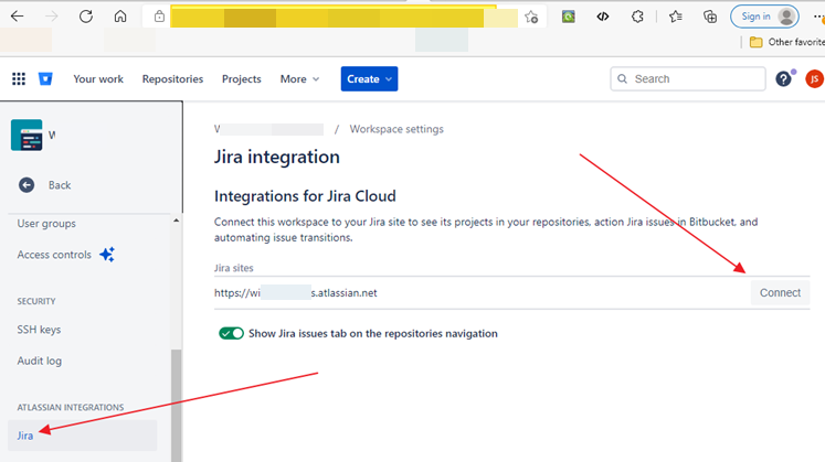

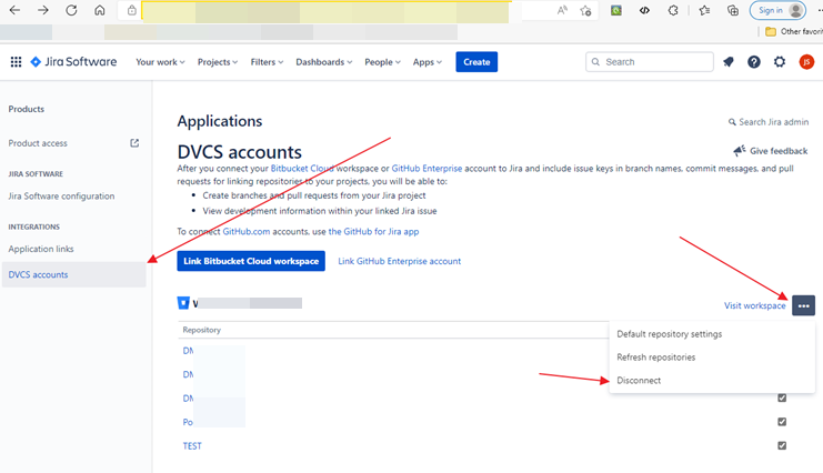

Michael Larson June 14, 2024
It has been a while, and I apologize for not updating at the time.....
So I just decided to take the chance and disconnect Jira and Bitbucket.  Then I reconnected them and it worked.   It walked me through the steps (3 I think) and I was done.  Took like 3 mins.
Hope this helps....
