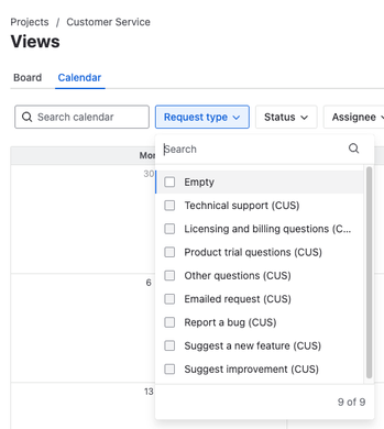

Can you provide a screen image of what you are seeing?
In my Company Managed Service Management project I have 8 Request Types. I see all 8 plus the "Empty" option in the Request Type filter in the Calendar view.

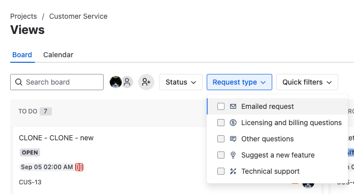

In the Board view the filter is limited to only the Request Types for which there are cards visible on the board.

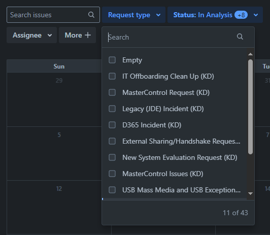

So that is our problem, When I select the search for request type is gives me 43 options which is a lot more than what we use. In particular I want to sear off of change requests and it is not an option and should be. I am not sure where these request types are being pulled from or if I can change where it is being pulled from

For the project that you are view in the above image, is the project key "KD"?
Have you reviewed the Request Types available in the project you are viewing and confirmed that there are not actually 43 Request Types in that project? That would be under Project Settings > Request management > Request Types.
My experience so far has been that list pulls only the request types from the project you are currently viewing.
Craig Hynek January 24, 2025

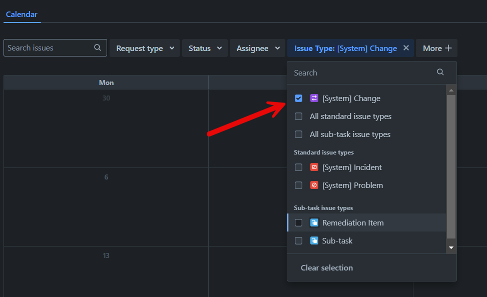

I believe I see what is going on.  I checked the information you provided, and it does match up to what is in the drop down. Instead of request type, we need to figure out how to filter off of Issue type. So, I will work on trying to get that filter to work. I have added to the search however it is not pulling the data into the calendar.

Only issues that have the Due date field set will be pulled into the calendar. Do you have any issues of that type in the project that have Due date set?
We do not use that field on change tickets.
Trudy Claspill
January 24, 2025
In order for issues to display on the calendar, there must be some date related information.
What date fields do you hope to use to display issues on the calendar?
As per the documentation for the field the due date and optionally the start date fields are the fields to use to place issues on the calendar.
https://support.atlassian.com/jira-service-management-cloud/docs/use-the-calendar-to-view-your-issues/
Scheduled date and or Starts Date Time
Trudy Claspill
January 24, 2025
Ah, I found that you can choose the date fields you want to use:
https://support.atlassian.com/jira-service-management-cloud/docs/show-issues-in-the-calendar/
