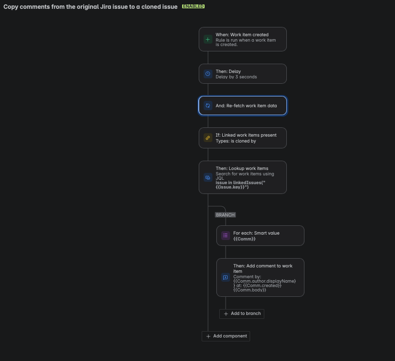

Hey @Brian Taylor
Use 2 more actions:
1. Delay - after item has been created.
2. Re-fetch - after delay.
that should solve your issue.
Ariel.
Brian Taylor
June 4, 2025
Arielei
That did not seem to fix the issue - the comments are still not showing

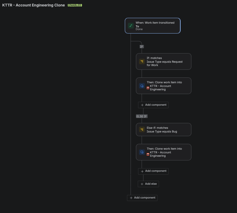

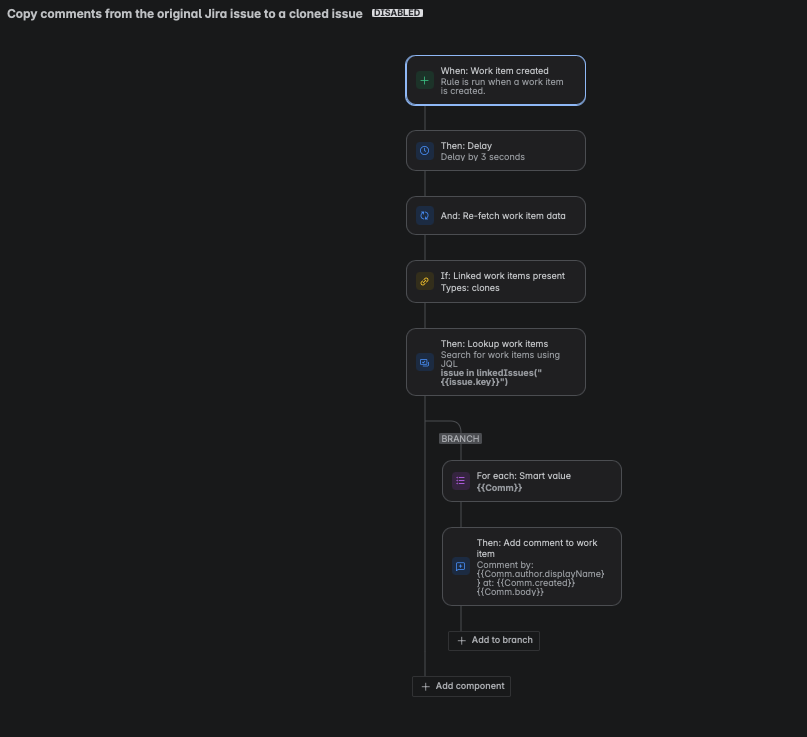

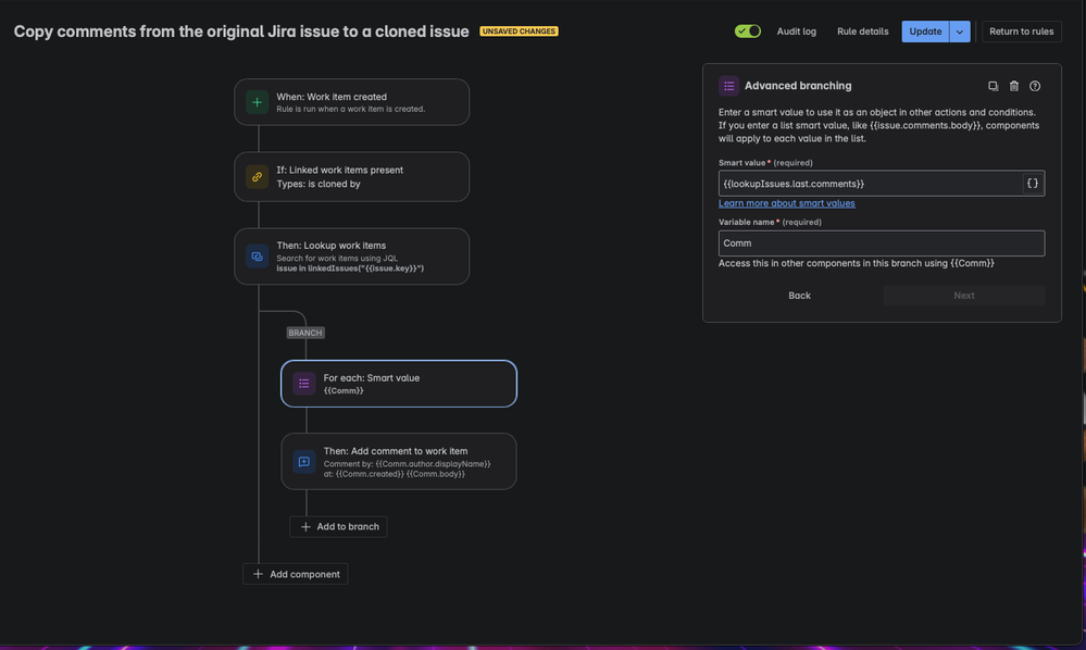

Mikael - I tried your suggestion, but it didn't work, and now I'm not getting any feedback in the logs.  I have attached both automation of the Clone and Comment copy for reference in case you see something else that maybe causing the issue
Screenshot 2025-06-04 at 11.05.41 AM.pngScreenshot 2025-06-04 at 11.05.11 AM.png

On the cloned work item, what is the link type used back to the original work item?
Brian Taylor
June 4, 2025
Both sides are set to Clones
Mikael Sandberg
June 4, 2025
Then I assume that you have changed the default link type, am I correct? As I mentioned above, the default is "is cloned by" as the outbound link on the original work item and "cloned" as the inward link on the cloned work item.
On the automation that should copy the comments, under Rule details have you checked to enable other rules to trigger it?
