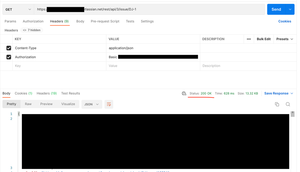

- Successful Cloud REST API call via Postman:
  https://{domain_prefix}.atlassian.net/rest/api/3/issue/DJ-1

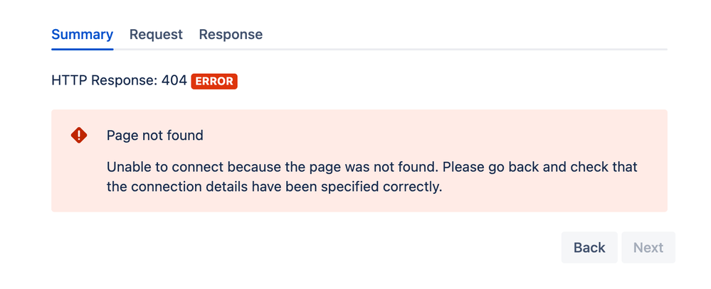

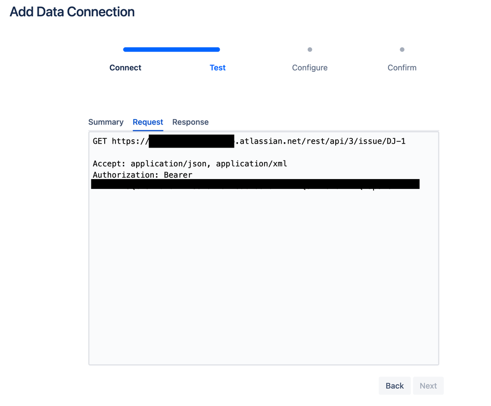

- Failed call via Forms Data Connection:
The key point difference here is the Data Connection uses the "Bearer" prefix for the Authorization header but the Cloud REST API uses the "Basic" prefix, I can't figure out a way to make these 2 mechanisms work together. I tried with the not encoded Base64 token as well but still does not work.
