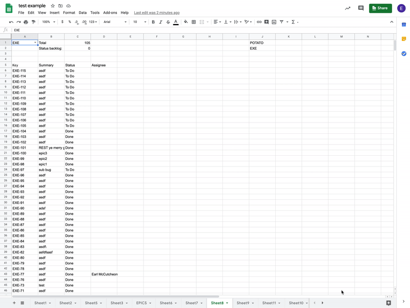

Alternatively you can use the =jira() formula in a different section of the page, But lower down in the page and doing all your formulas at the top. The sections below the rows with the =jira() formula will be overwritten, and the rows above will be left alone. In the following Example my project is EXE in cell 1 and referencing A1 in the =jira() formula below, all i need to do to update the formula is edit cell A1 and then any formula added to rows 4 and above will not be impacted when the data is refreshed:
And you can take this a bit further and add in a data validations drop down list in cell A1 for a quick referance back and forth between various projects and all your formulas above the data pull as well for a rapid project update on live data, The following example in the GIF below being super basic layout (but you can make this as elaborate as needed) with a couple =countif() formulas to show how they update as the data refreshes that count total cells with a value and statuses that are = "backlog" and then the data validation set up on A1 with referance to the project names in cells J1 and J2 so that the data updates on the fly when selected:
