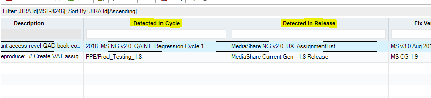

In HP ALM, we have two fields as shown in the attached screen for a defect/bug.
-  Detected in Cycle
Detected in Release
Is there a way we could have these two fields in Jira at the time of raising a defect so that above 2 fields will be automatically populated in ALM?
It seems that there is no directly mapped Field in Jira defect to represent this.

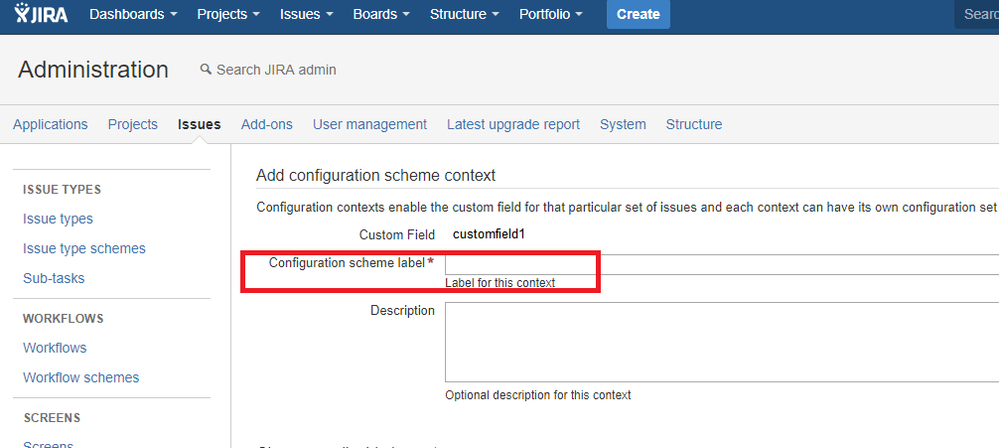

Thanks for the answer. Need to get more details on mapping the custom field to the project/issueType context. See the attached image- What should be the value we need to pass for the highlighted field? Is it the mapping DB table's Field name for 'customfield1'.  What is the  mapping DB table field for the scenario of having this Custom Field in 'Bug' issue type?
Tarun Sapra
April 2, 2019
The screenshot you have shared it from the field configuration section.
Please see the steps here to add a custom field (you need jira admin rights)
https://deviniti.com/support/addon/server/extension/latest/multilevel-structure-custom-fields/
And once you have added a custom field then you need to click on "Edit configuration as displayed in this page to configure projects and issueTypes against the projects.
https://deviniti.com/support/server/extension/latest/1.multilevel-structure/1.multilevel_structure_13.png
