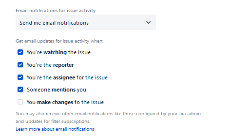

Are you receiving any notifications at all from Jira?
Have you tried any test cases - different ones where you're the reporter, the assignee, mentioned in a comment?
If they don't work then have you checked your personal settings in Jira and your email spam filter?
Hi Liam,
Creating a case, assigning myself to a case, being mentioned - nope. No notifications.
Personal Email settings in Jira - I have checked everywhere and can see nothing which would stop emails being sent to me.
Spam filter has also not been changed, and no Jira mails in the Spam folder,

If you're doing the tasks yourself, then you won't be getting notifications as you're doing the work.
