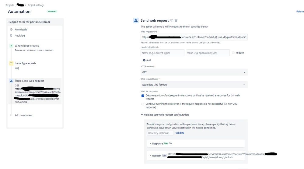

@Jennifer Luo I created the automation as you described on 12.04.22 as a GET and it works fine, however it is not unlocking the form. I tried to change the GET to POST, and even PUT but I get an error 'method not allowed'. I'm well aware it's user error as I'm not great with API requests. Could you tell me what the final piece is that I need to do so that the automation acutally unlocks the form for a customer on the portal to edit? Thanks so much!
Make sure you have your Authorization header details correct, I don't see anything else that could be missing!
Also make sure there is in fact a form attached to the issue - if not, it will not work since nothing is going to be unlocked.
@Jennifer Luo I finally for it to work, and yes part of the error was my authorization header, thank you for all your help!
