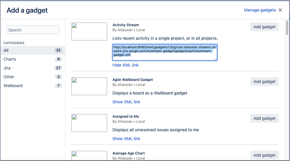

When we try to add a new gadget, we noticed that all of the URLs have "localhost" instead of our hostname:

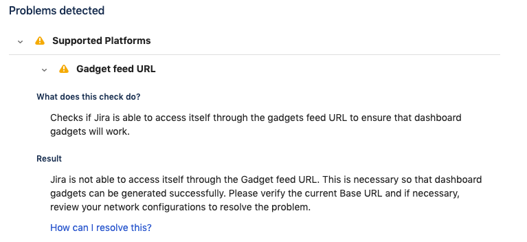

We also saw this health check error:
The base URL is correct.
We added arguments for -Dhttp.nonProxyHosts and -Dhttps.nonProxyHosts as directed in option #3 of https://confluence.atlassian.com/jirakb/jira-server-base-url-health-check-fails-859447384.html, using the hostname in our base URL, but we are not seeing any change in behavior.

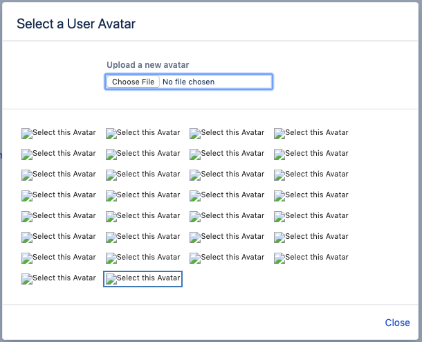

Avatars are also not available:

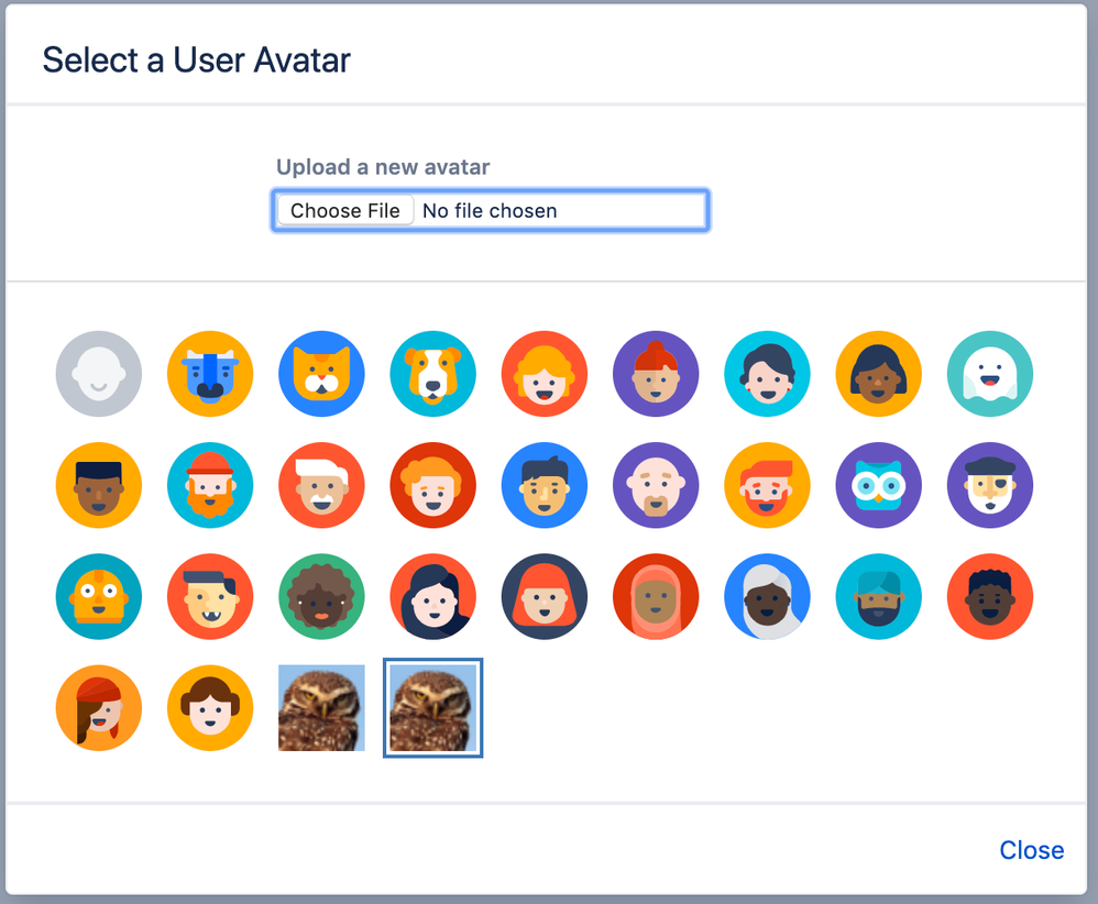

After restarting nginx, everything is working now:
Thanks for your suggestion - it was spot on.
