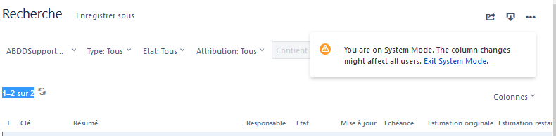

In the screen "issues/?jql=order by lastViewed DESC" I need to add the "responsable" column in the displayed list.
I try to use the "columns" link at the right if the screen. The column is present in the "system" list of available fields but not in "my default configuration" list of available fields.
How can I change "my default configuration" to make the "responsable" column appear in the list of issues ?
Thanks. Mbo

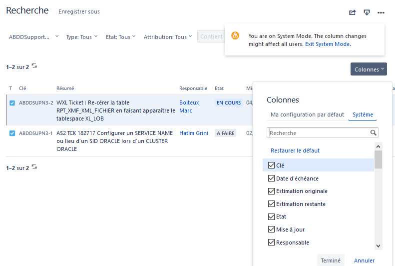

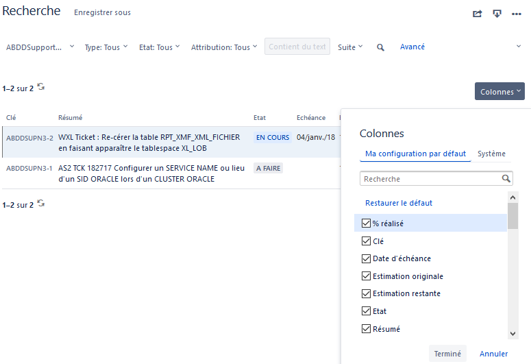

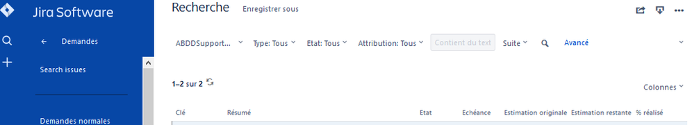

Could you please add some screenshots from the System view and the defaults view? Maybe this might help us finding the problem.
Thank you for your message. I have 4 screenshots. (I post this answer + 4 answers to have 4 separate pictures)
I think you'll find the field underneath the checked fields.
There's another list with unselected fields under the selected ones.
